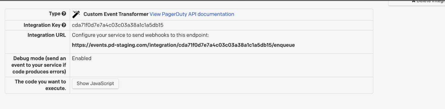

@stephen, with event transforms there’s an Debug Mode option that seems to swallow JS errors if disabled. We tried to reproduce this by creating an event transform integration, turning off debug mode and no incidents get created. Turning it back on and an incidents get created, displaying the failure reason.
There is some additional documentation about the use of PD.fail and PD.assertType here. The transform calls PD.fail the events are dropped, so they do not surface / show up anywhere.
That is on the Custom Event Transformer though, not on a Custom App, the Debug Mode option is not there for apps
